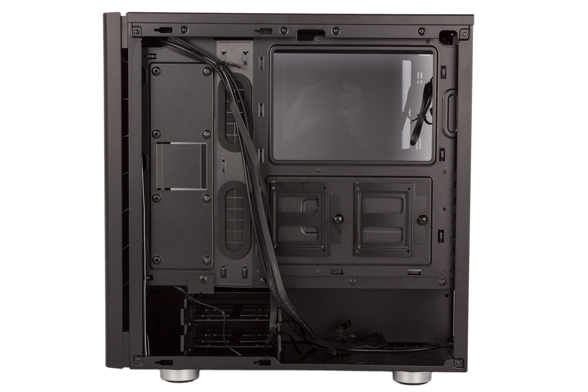

The case’s internal cables are all blacked out for minimum visibility (at least in the black version). When it comes to routing them, Corsair has holes positioned above, below, and to the side of the motherboard, and of course you can stuff excess lengths into the lower compartment. The larger holes, including one cut into the PSU shroud, are protected with rubber grommets. You don’t get any Velcro cables ties, and space behind the motherboard tray feels a bit tight, but in the end we didn’t have many problems tidying our cables up.
